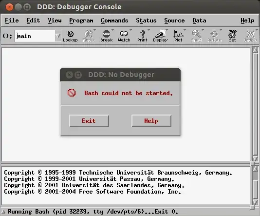

To get ddd to work with the bash debugger on bash scripts, it's necessary to install bashdb too.
If it's not installed, you get:
Afterwards, ddd seems to work normally:

This is a regression introduced in DDD 3.3.12, see bug #41649.
The last usable version is 3.3.11.
