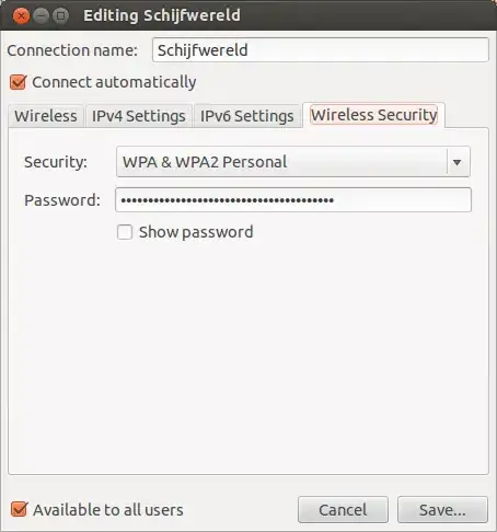

Left click the connections icon at the top right.
Choose edit connections and then choose edit on the connection you need and click the wireless security.
And click the 'show password'checkbox
