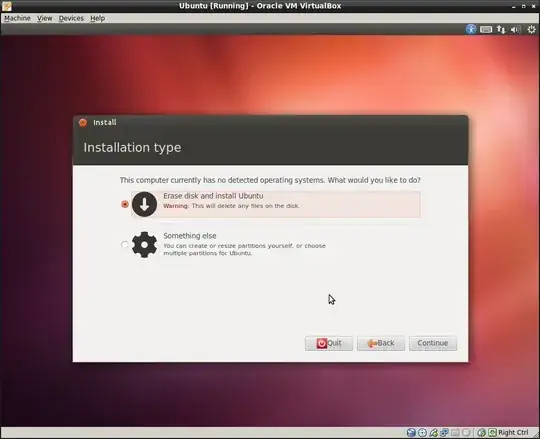

Go to the Ubuntu website to download Ubuntu. Choose the 32bit version. Burn the ISO to a CD. Since you have Windows XP, you can use Free ISO Burner , once that is done, boot from the newly created CD, make sure that you system is set to boot from CD.
When you get to the Installation Type screen, choose erase and install.
Continue the installation following the on screen instructions.
