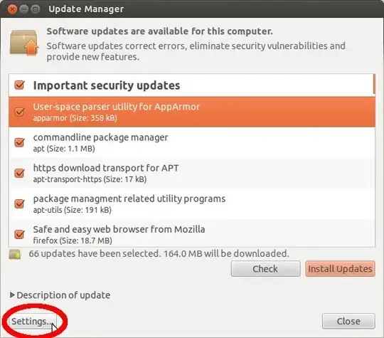

This sounds like it may be an issue with third party repos. I know Google's repo takes several minutes to respond here sometimes. If you have third party repos set up, open Update Manager, click Settings, then the "Other Software" tab. Uncheck all checkboxes, then hit close.
Update Manager Update Manager - Other Software
Now, fire up a terminal and use the following command and see if it is any better with the following command:

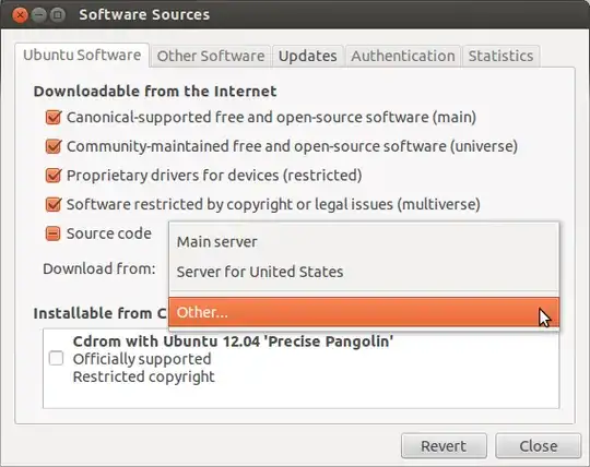

If that does not work, you can have the update manager select the best main repos to use automatically. To do that, open Update Manager, then click Settings. Select the Ubuntu Software tab, then in the "Download from:" dropdown, select Other...
Update Manager - Ubuntu Software Tab

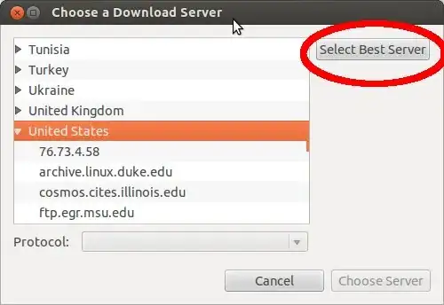

Now, in the window that pops up, click "Select Best Server"
Update Manager - Choose a Download Server

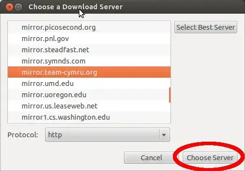

It will then perform several tests to select the best server for you. Once it is completed, just click Choose Server.
Now, fire up the terminal and check again.
