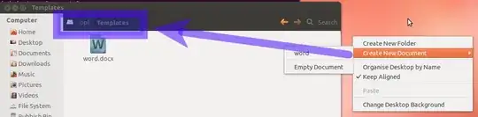

It is indeed possible to create a global template folder as the picture shows.
To do this you can edit the file ~/.config/user-dirs.dirs
Change the line XDG_TEMPLATES_DIR="$HOME/Templates" to XDG_TEMPLATES_DIR="/opt/Templates" if your global folder is in /opt/Templates
Note 1 - you should consider carefully the permissions you give this template folder. I would suggest you should give read-only rights with a common group shared by those users of a client. Obviously try to avoid 777 rights to this folder since this makes the folder read-writable to everyone and anyone.
Note 2 - the XDG_TEMPLATES_DIR folder needs to be EITHER a folder locate in the users home or an absolute folder (full path to the folder starting with /)
Note 3 - you dont necessarily need to modify user-dirs.dirs. You could remove the local home-folder and soft-link it to your global templates folder i.e.
cd ~/
rmdir Templates
ln -s /opt/Templates Templates
Note 4 - logout and login for changes to take effect
