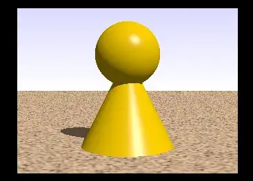

This is an example output
save the contents from here as povpawn.pov
Now run povray
povray +Ipovpawn.pov
