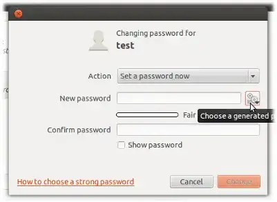

You can open the system preferences (top right gear symbol). There is the user program. This is a GUI Tool for adding and changing users.
You can also generate a random password:
