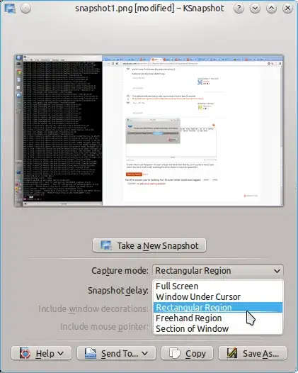

In KDE I like to use KSnapshot Spectacle (renamed). It's much simpler and faster than Shutter, so it's useful in those cases where you don't need to edit anything (for which Shutter is way more powerful!).
