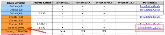

Well, the solution is to use the special 2.6.34 kernel DMP supplies here, which is required to install Ubuntu 10.04.
I don't know if your "vendor" is the manufacturer (DMP Taiwan), or a retailer/distributor, but DMP makes this fact perfectly clear on their support page:
In any case, you should start with the latest Ubuntu 10.04.4 Alternate Install CD, available from this page. That way, the install is text based and any errors/problems are clearly shown, which we can help you troubleshoot.
