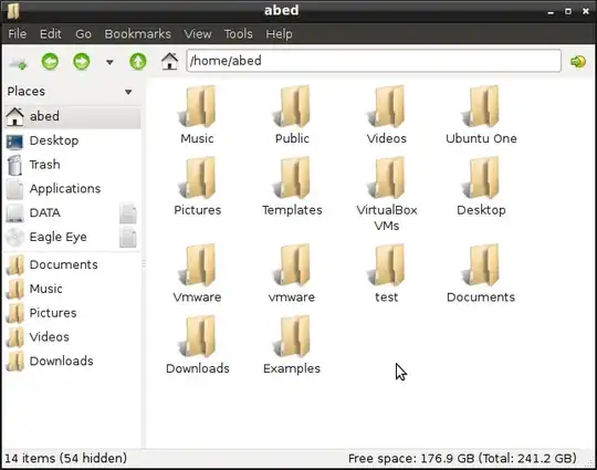

When you open file manager you get
enter image description here Now go to Menu --> Accessories --> File Manager --> right click, and choose properties

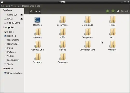

Change pcmafm to nautilus and you will get

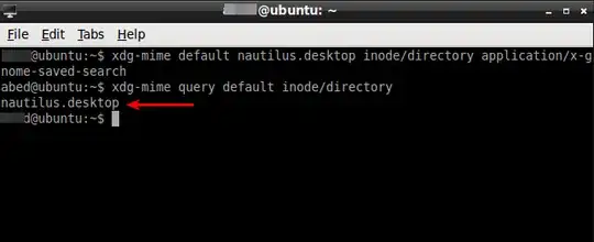

In Ubuntu 14.04 here's what I did. I did a fresh installation of Ubuntu 14.04, and then installed LXDE. Once that was done, I set nautilus as a default file manager using the following command:
xdg-mime default nautilus.desktop inode/directory application/x-gnome-saved-search
and then I checked the current default file manager using the command below:
xdg-mime query default inode/directory
and it showed Nautilus as the default. See image below.
