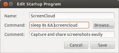

You could try starting Shutter with a delay.
  1. Go the the startup applications dialog, choose Shutter and hit Edit.
  2. Put sleep 8s && before the value in the Command field.
  3. Hit Save.
Using ScreenCloud in this example, as I stopped using Shutter
I'm using ScreenCloud in this example because I don't have Shutter in my startup applications.
