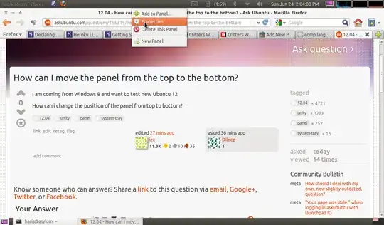

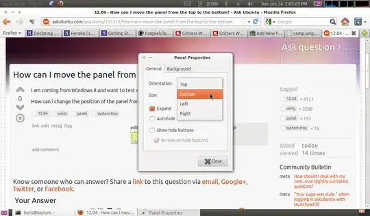

"Super+Alt+Right-click" on the top panel and select "properties".
Choose "Orientation" from it.

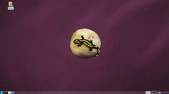

Here it is:
  • Install CCSM,
  • Install Fbpanel,
  • Go intoto Startup applications and add Fbpanel to startup,
  • Go into CCSM (Compiz Config Settings Manager) and disable the Unity plugin,
  • Power off your device. Upon restart you should have the Fbpanel as bottom panel
    and no Unity panels.
  • Customize Fbpanel, all you need to edit is in this file:
    http://fbpanel.sourceforge.net/configs/default
That's is it!
Later edit: initially the shutdown restart and lock may not work but i uploaded my config file on google drive with repaired commands:
http://www.editmedia.ro/2014/04/move-unity-bar-to-bottom-disable.html
