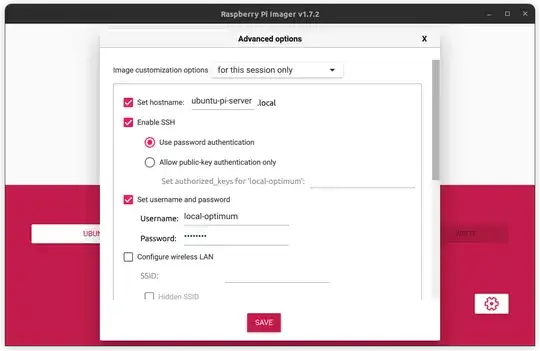

If you can't easily connect a "head" to the Pi, Install the Ubuntu server instead. The detailed instructions for installation are in the official Ubuntu website.
These instructions include how to set:
  1. Hostname
  2. Enable ssh
  3. Set Username and password
Using the advanced option of the Raspberry Pi Imager: Advanced Option Pi Imager
