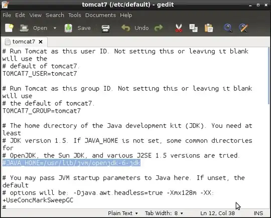

You can try this:
Just press Ctrl+Alt+T on your keyboard to open Terminal. When it opens, run the command below.
gksudo gedit /etc/default/tomcat7
When the file opens, uncomment the line that sets the JAVA_HOME variable.
Save and restart tomcat7 server.

sudo -H gedit /etc/default/tomcat7
Replace #JAVA_HOME=/usr/lib/jvm/openjdk-6-jdk with the output you copied from $JAVA_HOME.

Just add following line in /etc/default/tomcat7 at where JAVA_HOME variable is defined
JAVA_HOME=/usr/lib/jvm/java-7-oracle
