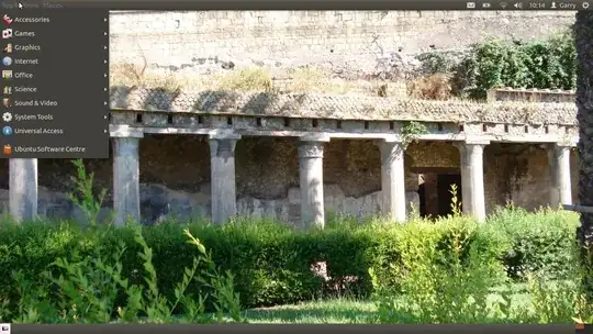

At first it looked very well, like the screenshots on the Website. But since 2nd restart my Desktop looks like in Ubuntu 10... What to do?
UPDATE: After complete new installing Ubuntu 12.04 I watched step by step when "new" Gnome look dissappears. So I found out that when I start Nvidia Xserver settings first time & set my 2nd Screen (HDMI Port) from inactive to active, gnome jumps to old style, exactly as in Gerrys Screenshot. I deactivated it again, saved this to /etc/X11/xorg.conf again. But Gnome stays in old look. So I assume its something with this stuff. I am using Nvidia GeForce GT 530 & "accelerated Graphics Driver version current" (hope, I translated correct) Thanks for you help so far, hope you can solve this Problem...

If it looks a bit like the picture below then you've probably booted into Gnome classic. When you're logging in after starting your computer there are options for which desktop environment you'd like to use (where these are depend on which desktop manager you use but should be near your username - if you're using lightdm just click on the logo to the right of your username). Set that to gnome instead of gnome-classic and you're done.
gnome-classic screenshot
