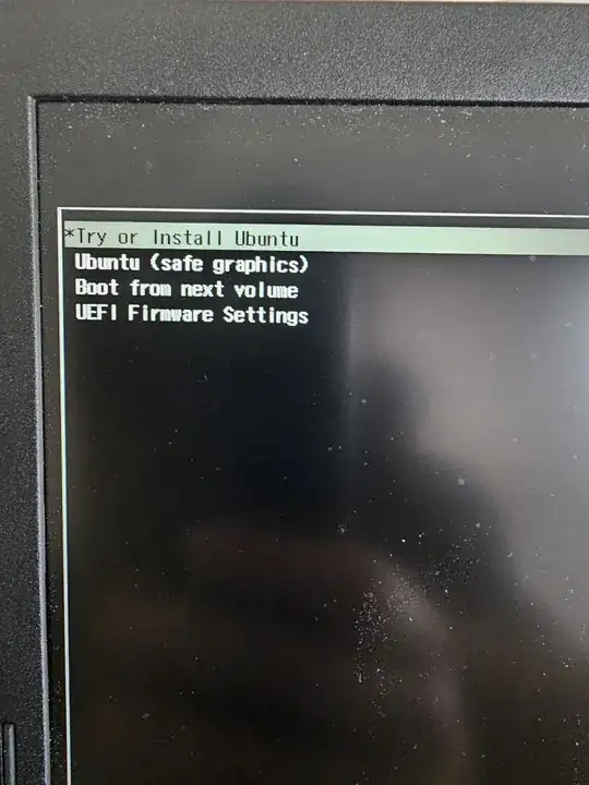

The first thing that appears is a small error text error: file '/boot/' not found. Can't find command group_p.
Then the small menu with the text (Grub).
try or install Ubuntu
Ubuntu (safe graphics)
Boot for next volume
UEFI Firmware Settings
The problem here is that nothing happens when I choose to press any of these except the error text error: file '/boot/' not found

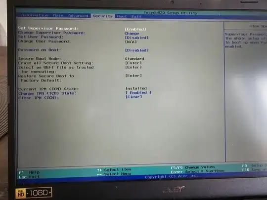

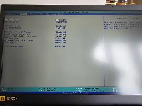

I have also tried using Rufus instead of balenaEtcher. I have turned off fast boot and Secure Boot, but I still have the same problem as before.
