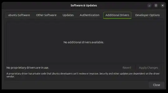

The system no longer has an NVIDIA driver installed and the documented procedures no longer work.
Note that the above means this question cannot be solved using sudo ubuntu-drivers install as described in How to install Nvidia driver on ubuntu
