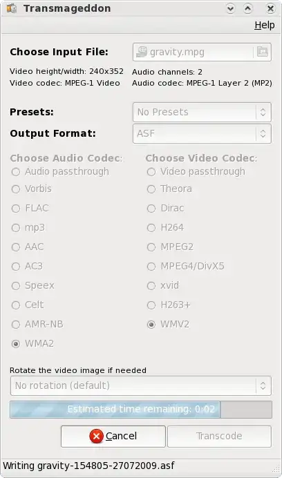

For video encoding I use transmagedon. You can find it in Ubuntu Software Center. By default, it utilize multiple cores.
alt text
