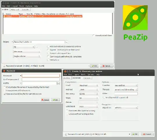

PeaZip enter image description here enter image description here
I can't believe I learn about this program only now, after using ubuntu for a year, reading omgubuntu.co.uk, webupd8.org etc. :) As you can see it has all one would need.
It is installed via deb package. For me it installed without errors but I didn't get a Dash shortcut for it. Since the portable version (no installation required) works fine, I won't bother troubleshooting it. Right click > View Image for higher resolutions.
