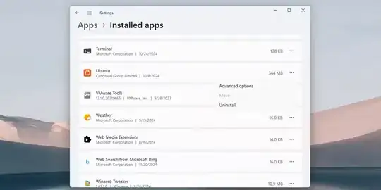

Modifying the system python will almost always destroy Ubuntu, as many system packages depend on it.
Since you are using WSL, the easiest way to fix the issue is to uninstall WSL and reinstall it.
Open PowerShell. Run the command wsl --unregister Ubuntu (to see a list of installed systems, run wsl -l -v)
Afterwards, open settings > Apps > Installed Apps.
enter image description here (Image source)
Find Ubuntu, and click on Uninstall.
Finally, open Windows store and install "Ubuntu" to reinstall WSL.
