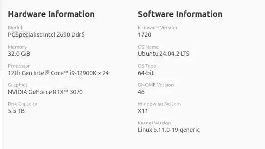

My computer takes 12 minutes to boot, after i log in, it goes to a black screen where the cursor is an X shape and then into my normal home screen, Below is the results of a systemd-analyze:
Startup finished in 3min 7.195s (firmware) + 2.293s (loader) + 50.388s (kernel) + 8min 41.810s (userspace) = 12min 41.688s
graphical.target reached after 8min 25.382s in userspace.
Here is the results of a systemd-analyze critical-chain:
graphical.target @8min 25.382s
└─udisks2.service @8min 11.337s +14.044s
  └─basic.target @8min 11.319s
    └─sockets.target @8min 11.319s
      └─cups.socket @8min 11.407s
        └─sysinit.target @8min 11.308s
          └─systemd-resolved.service @8min 11.266s +42ms
            └─systemd-tmpfiles-setup.service @8min 11.208s +36ms
              └─systemd-journal-flush.service @7min 30.644s +40.537s
                └─systemd-journald.service @6min 40.979s +49.645s
                  └─systemd-journald.socket @186ms
                    └─-.mount @172ms
                      └─-.slice @172ms
System information:
my system information
