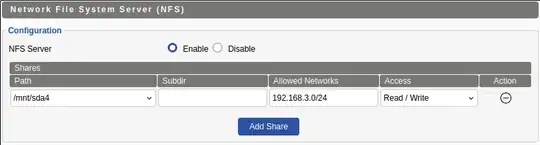

On Ubuntu 20.04.6 LTS I want to share a USB drive connected to a DD-WRT router using NFS, but I cannot have writing permission for a regular user. The NFS share is indeed setup read/write in the router.
dd-wrt screenshot

NFS maps UID/GID's directly, so the local user UID must match the permissions on the remote side.
First, figure out what your users UID is by running id -u; id -g on your machine. This will give you two numbers - UID and GID
Second, connect to the DD-WRT system via e.g. SSH, and log in as root. Run chown UID:GID /mnt/sda4/ to change owner of the shared directory to your user. UID:GID is the two numbers you got when running id.
