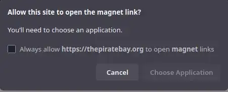

Clicking on a magnet-link in firefox results in

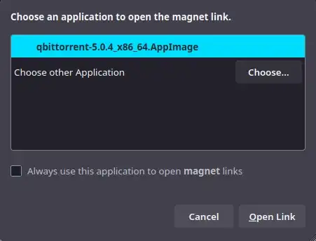

Clicking on `Choose Application leads to

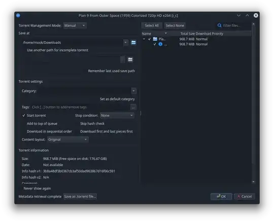

Clicking on Open Link opens qbittorrent:

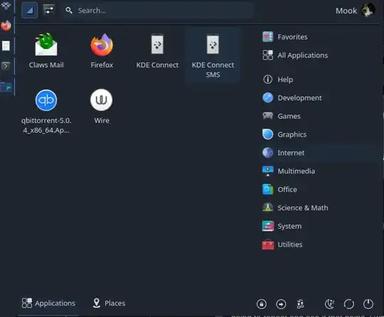

I also have the icon in my application launcher:
