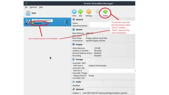

I have found a useful work-around: first of all the start of the Virtual Machine headless must be rimain exactly how it is described in the question. In fact normally it is not necessary to start the GUI of the Virtual Machine, but only in some rare cases.
Manual start of the Oracle VirtualBox GUI
After the boot process of the Host is completed and when is necessary to start the GUI of the Vitual Machine I can start the Orcale Virtualbox GUI by a double click on the VirtualBox Icon, or by the command VirtualBox executed in a terminal.
In my case it is opened the image showed below: Oracle VirtualBox GUI with VM running
The image highlights that:
  1. the Virtual Machine is Running
  2. the button on the top right change from Start to Show.
Show the VM GUI by the button Show
Clicking on the button Show (which is highlighted in the previous image) it is possible to start the GUI of the Virtual Machine.
This is exactly what I want because, the headless starting of the Virtual Machine it is sufficient in most cases of boots of the system, and only sometimes it is necessary open the GUI of the Virtal Machine.
