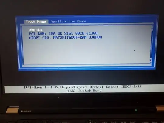

Update on 2/28/2025 . I've added a picture of the menu that appears after a warm boot. I can move the cursor up and down, and change menu with TAB but pressing Enter or waiting 10 seconds does not activate anything.
Based on the fact that I edited Grub to remove the Windows 10 option, this is Grub, not the EFI Boot Manager. See below for that information.
Menu after warm boot
