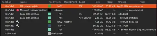

I suspect the issue is because I have ended up with two efi boot partitions, one at /dev/sda1 and the (new?) other at /dev/sda6 which has automounted as /boot/efi. This is the current hard-drive layout according to GParted:
gparted screenshot showing two EFI partitions

  1. In Ubuntu, changed fstab mount to /dev/sda1 (using UUID given by lsblk -f)
  2. In Ubuntu, used gparted to remove boot, esp flags from /dev/sda6 It seems these flags then need to be applied to /dev/sda1 for the next step to work

Summary: I think the Ubuntu installation somehow changed the GUID-type of the Windows partition to "Linux-filesystem" which then confused all attempts by Windows Recovery to repair the boot settings. I don't think Linux pays any attention to the GUID type, but Windows will completely ignore a partition if it's set incorrectly.
