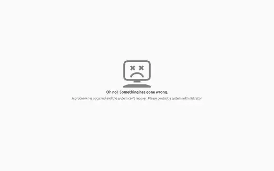

Upon rebooting, the laptop briefly goes to the "Lenovo + Ubuntu logo" screen, then the white screen with the "Oh no! Something has gone wrong. A problem has occurred and the system can't recover. Please contact a system administrator" message appears.

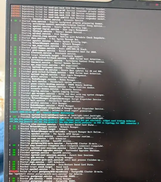

Edit: If I start spamming Ctrl+Fn+Alt+F6 before the white screen appears, I can briefly see this log: enter image description here

I was able to solve this myself and posting this here for anyone who might run into the same issue. The key was to access the grub recovery menu, which I was able to do by hitting escape once the "press enter" screen disappeared, but before the ubuntu logo showed up. From there I was able to select recovery mode and go to the command line.
From the command line, connected to wifi following this How do I connect to a WiFi network using nmcli? . Then I was able to run the steps here After Upgrade to Ubuntu 20.04: "Oh no! Something went wrong" , which were enough to successfully reboot.
