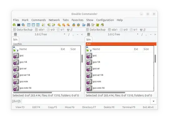

Directory screenshot
The CC version check failed:
