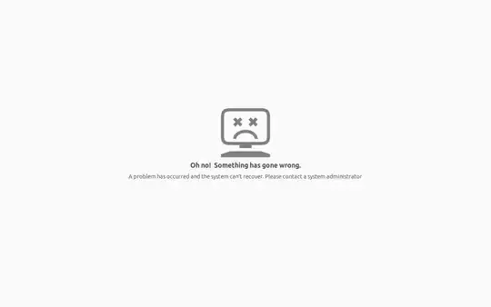

After booting and decrypting my laptop (dm-crypt), the user login screen showed this error message:
I managed to summon the command line by pressing the Esc + Ctrl + Alt + F3 keyboard combination.

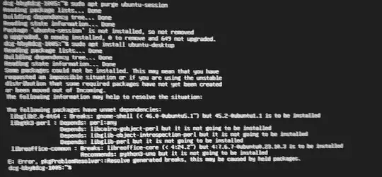

I followed commands like:
  • sudo apt -f install and sudo apt upgrade
  • sudo apt purge ubuntu-session and sudo apt install ubuntu-desktop (which seemed to fail)
    result
I tried reboot but it got even more stuck, so I reinstalled ubuntu-session, but I got the same error.

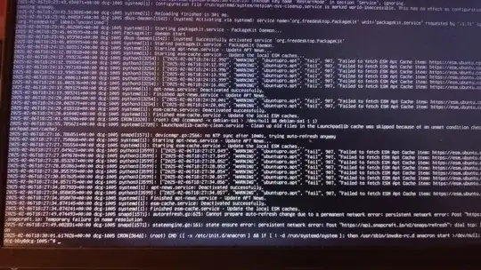

When I ran less /var/log/syslog this is what showed up:
Command line putput

I managed to solve it.
I went back and forth upgrading and trying to add dependencies. Also auto removing files.
The last thing I did was "do-release-update" to 24.10 -- I had tried previously but it always failed but when I did it in root mode it worked.
That seemed to be what really worked for me.
