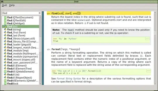

You might want to check out Zeal. I just started implementing it this weekend. It's intended to be a documentation browser like Dash, working on Linux.
Here is a screenshot:
Zeal Screenshot

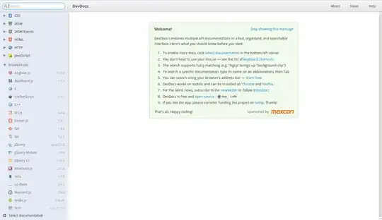

Perhaps devdocs.io would be an option. It is also available as app extension for google chrome.

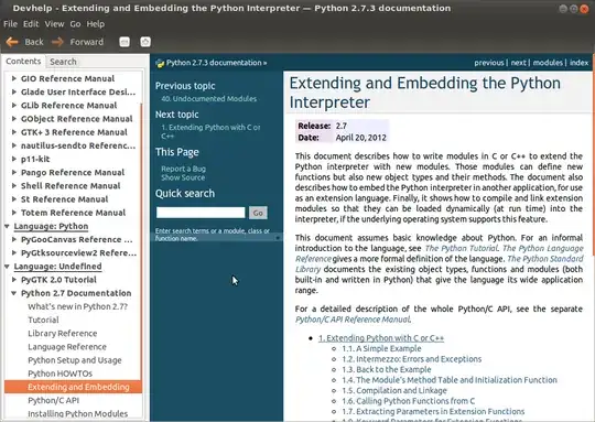

devhelp Install devhelp may help you
Devhelp is an API documentation browser for GTK+ and GNOME. It works natively with gtk-doc (the API reference framework developed for GTK+ and used throughout GNOME for API documentation). If you use gtk-doc with your project, you can use Devhelp to browse the documentation.
website
screenshot
