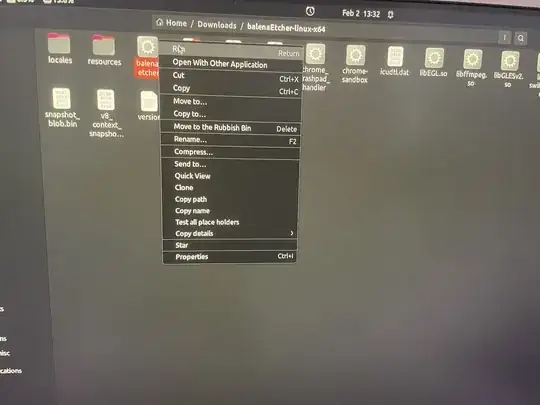

1.3: Plug in a USB with atleast 8GB of space. Navigate into the BalenaEtcher folder and right click the executable to run it.

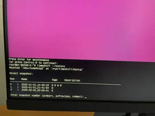

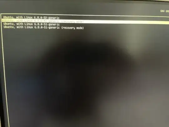

If you have a login black screen, use your terminal username and password to login. If not, try Alt+F3 to bring up the command prompt. Skip to * if you have a command prompt. Failing that, reboot your system and repeatedly press Esc. You don't want the grub menu, if you get that enter the exit command to try again. You should get this screen and go through the options to bring up a terminal: enter image description here enter image description here enter image description here At this stage, you have access to a terminal* Enter timeshift --restore and select the backup you want to load: enter image description here Go through the prompts selecting the backup and other options.
