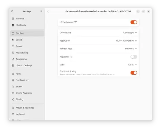

I opened the Settings and went to the Displays section, because the resolution of my second monitor had changed since the last boot. The strange thing is that the window title was "christmann informationstechnik + medien GmbH & Co. KG CH7218" as you can see in this screenshot:
Usually the title changes from "Displays" to some description of the monitor once you select one, so for me it should be "LG Electronics 27"". I tried to get some more information by running: ls /sys/class/drm/*/edid | xargs -i{} sh -c "echo {}; parse-edid < {}" (from this question) and got the following output
