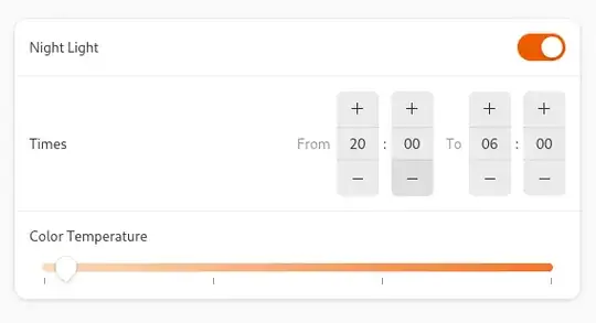

I am not sure when this disappeared. Probably during upgrade from 24.04 to 24.10.
On my system, there is no option to set the Night Light from "Sunset to Sunrise".
What can be the cause? And how can I restore old functionality?
I found your question because I had the same issue. Found the answer in a reddit post. I had to enable geolocation service. I don't know why it was not enabled anymore.
To enable it, go to Settings → Privacy & Security → Location and toggle Automatic Device Location on.
