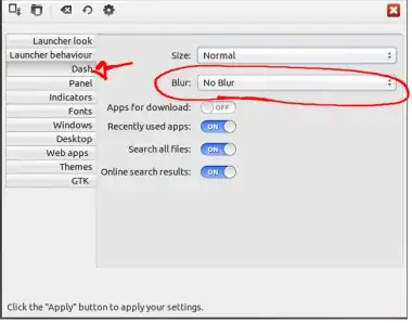

I. Install Unsettings. Type in terminal
sudo add-apt-repository ppa:diesch/testing
sudo apt-get update
sudo apt-get install unsettings
Open Unsettings. You can try 2 changes.
  • First, go to Dash > Blur and select No blur.
No blur
  • Second, go to Themes and change Graphics Mode to Force low graphics mode.
Low graphics mode

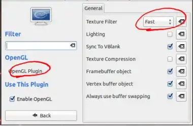

II. Install the Compiz Config Settings Manager. Type in terminal
sudo apt-get update
sudo apt-get install compizconfig-settings-manager
Open the compiz manager. Go to OpenGL and select Texture Filter > Fast
Texture filter
Remember to log out!

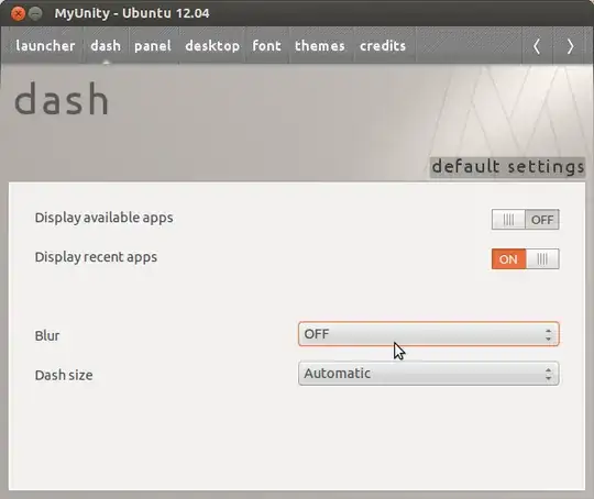

Deactivating the "blur" effect might help.
To do so install "MyUnity" in the Ubuntu Software Center. Then you can disable the blur effect by setting the "Blur" option on the "dash"-tab to "Off".
Here's a screenshot: window screenshot showing disabling of blur effect

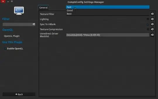

Step 4: Reduce Graphics Settings: If all the previous steps didn't improve speed noticeably, or if you are still hungry for more performance, reduce the Graphics Settings for Compiz. I got this idea from Ed Villegas' Answer for Ubuntu 12.10. But remember, this change affects graphics quality of the entire Ubuntu system, not just Unity alone! Open Compiz Config->OpenGL->Texture Filter and set it to Fast.
Reduce Compiz Graphics Settings Level
