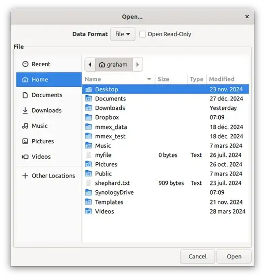

After opening GNUCash go to File > Open and from the options provided under Home select OneDrive (note: not shown in my graphic as I don't have the OneDrive client installed but Dropbox instead which would work in this case with GNUCash so the same principle applies) and the folder where you GNUCash data is stored.
In Summary
The GNUCash data files should be accessed through the Home/OneDrive/... folder in Ubuntu in order to ensure that the files are synchronised correctly with GNUCash clients on other hosts and that the other clients also access the same data stored in the cloud in the same way.
