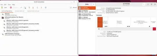

And this is what my grub cutomizer and parted states Haven't been doing any system upgrade or installing stuff...so slightly out of touch.enter image description here /dev/nvme0n1p1 seems to have all the active partitions to boot.

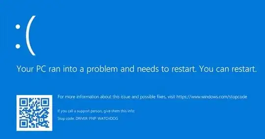

I tried this link, but for this I need to able to login to Windows 11 command prompt. I tried two different USB drives and different ports, but I'm facing this issue now:
Stop code DRIVER PNP WATCHDOG

sudo cat /boot/grub/grub.cfg | grep menuentry
if [ x"${feature_menuentry_id}" = xy ]; then menuentry_id_option="--id" menuentry_id_option="" export menuentry_id_option menuentry "Ubuntu" --class ubuntu --class gnu-linux --class gnu --class os $menuentry_id_option 'gnulinux-simple-4cd02128-ebde-4341-ad07-3620623d26ec' { menuentry "Ubuntu, with Linux 6.8.0-51-generic" --class ubuntu --class gnu-linux --class gnu --class os $menuentry_id_option 'gnulinux-6.8.0-51-generic-advanced-4cd02128-ebde-4341-ad07-3620623d26ec' { menuentry "Ubuntu, with Linux 6.8.0-51-generic (recovery mode)" --class ubuntu --class gnu-linux --class gnu --class os $menuentry_id_option 'gnulinux-6.8.0-51-generic-recovery-4cd02128-ebde-4341-ad07-3620623d26ec' { menuentry "Ubuntu, with Linux 6.2.0-33-generic" --class ubuntu --class gnu-linux --class gnu --class os $menuentry_id_option 'gnulinux-6.2.0-33-generic-advanced-4cd02128-ebde-4341-ad07-3620623d26ec' { menuentry "Ubuntu, with Linux 6.2.0-33-generic (recovery mode)" --class ubuntu --class gnu-linux --class gnu --class os $menuentry_id_option 'gnulinux-6.2.0-33-generic-recovery-4cd02128-ebde-4341-ad07-3620623d26ec' { menuentry 'UEFI Firmware Settings' $menuentry_id_option 'uefi-firmware' {
sudo update-grub
Sourcing file `/etc/default/grub'
Sourcing file `/etc/default/grub.d/init-select.cfg' Generating grub configuration file ...
Found linux image: /boot/vmlinuz-6.8.0-51-generic Found initrd image: /boot/initrd.img-6.8.0-51-generic Found linux image: /boot/vmlinuz-6.2.0-33-generic Found initrd image: /boot/initrd.img-6.2.0-33-generic Warning: os-prober will not be executed to detect other bootable partitions. Systems on them will not be added to the GRUB boot configuration. Check GRUB_DISABLE_OS_PROBER documentation entry. Found linux image: /boot/vmlinuz-6.8.0-51-generic Found initrd image: /boot/initrd.img-6.8.0-51-generic Found linux image: /boot/vmlinuz-6.2.0-33-generic Found initrd image: /boot/initrd.img-6.2.0-33-generic Memtest86+ needs a 16-bit boot, that is not available on EFI, exiting Warning: os-prober will not be executed to detect other bootable partitions. Systems on them will not be added to the GRUB boot configuration. Check GRUB_DISABLE_OS_PROBER documentation entry. Adding boot menu entry for UEFI Firmware Settings ... done
