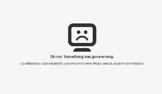

My Ubuntu desktop is booting to a gray screen with this error message:
Oh no! Something has gone wrong.
A problem has occurred and the system can't recover.
Please contact a system administrator.
I have tried:
  • Rebooting
  • Choosing an older kern with GRUB. My default is: Linux 6.8.0-49, but I get the same result with the oldest kernel (6.5.0-44).
  • I booted into recovery mode and updated all packages (sudo apt update && sudo apt upgrade), but this did not resolve the issue.
  • I checked disk space - the '/' partition has 51GB free.
  • I added 'nomodeset' in GRUB, but it made no difference.
  • I used the command line to install Xubuntu to see if a different desktop environment would help, but the same issue occurs.
  • Tried Ctrl + Alt + F2 to access a text console, but the cursor flashes indefinitely and does not accept input.
  • Reinstalling the nvidia drivers.

I had a dual boot (Windows 10 and Ubuntu).
This video solved my issue: https://www.youtube.com/watch?v=5ipmJIVJSho
After fixing my broken ubuntu using the above tutorial, grub menu didn't show and it was going straight to ubuntu after delay. (therefore I could not access windows 10).
I solved it using the following:
Check if GRUB boot menu is hidden. Try holding Shift (for BIOS systems) or Esc (for UEFI systems) right after your BIOS screen. If GRUB appears, your menu is just hidden.
If it appears, log into Ubuntu and edit the GRUB configuration:
sudo nano /etc/default/grub
Look for these lines:
GRUB_TIMEOUT_STYLE=hidden
GRUB_TIMEOUT=0
Change them to:
GRUB_TIMEOUT_STYLE=menu
GRUB_TIMEOUT=10
Save (Ctrl + X, then Y, then Enter) and update GRUB with sudo update-grub
Then reboot with sudo reboot.
