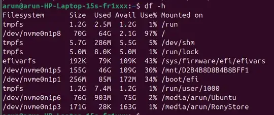

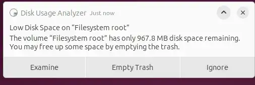

I am bit surprised to get a low disk space warning since the root filesystem is having 70GB memory. Recently I upgraded my Ubuntu version. I suspect that is causing this problem. Can anyone help me debug and free up space in the root filesystem?
df - h results:
df - h results
Low Disk Space on "Filesystem root" error:
Low disk space error

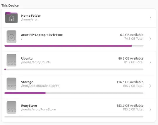

Disk Analyzer:
Disk Analyzer View
