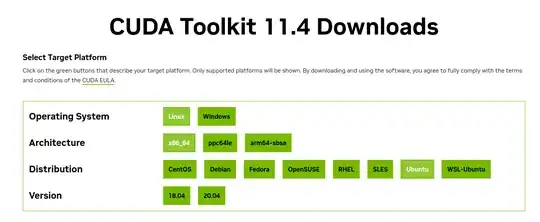

Accordingly, CUDA Version: 11.4 is needed. However, Ubuntu 24.04 is packaged to install CUDA 12 when sudo apt purge nvidia-cuda-toolkit is executed. Also, nvidia website did not provide CUDA 11.4 for Ubuntu 24.04 cuda11.4.
Can I install CUDA 11.4 in Ubuntu 24.04? If so, how?
Update:
Following @ubfan1's answer, in my download folder, I did the following but encountered a difficulty. The gcc ver.13.3 in Ubuntu 24.04 is not suitable for compiling cuda11.4. This answer states that gcc 11 is suitable for CUDA 11.4.1 which was downloaded. How do I install that gcc 11 into /usr/local/cuda11.4/bin?
$ sudo chown user1 /usr/local/
$ wget https://developer.download.nvidia.com/compute/cuda/11.4.1/local_installers/cuda_11.4.1_470.57.02_linux.run

Sun Bear
  • 3,014
Answer 1077061 is the best place for explicit instructions so this is for the problem of installing an older release, with out-of-date libraries and drivers. Nvidia offers two install mechanisms, a deb package and a run script. The goal is to get all of the CUDA release into its own directory, so system areas are not polluted with old libraries. unpacking the deb file used to be an easy way to do this, but later releases made this harder, so the .run script example is used here.
The .run scripts are for a CUDA release, get the one for the latest OS offered (20.04 in your case). This script will try to make a directory in /usr/local, even if it doesn't need to (i.e. you make it yourself owned by you). Rather than try to edit a fix into a 1.5GB script, I took temporary ownership of /usr/local so I could run the script without sudo. The script may attempt writing something in /usr/share, but I never bothered taking ownership of that -- I didn't care about whatever (icons?) were not installed.
./cuda-release-xxx.run and accept the license.
Then a text menu will allow you to tailor the installation. Uncheck the driver, you should already have a running Nvidia driver from the standard repos on your system that gets updates when needed. Now go to the options, and you can change the install location for libraries and executables. Change them to /usr/local/cuda-11.4/lib64 and /usr/local/cuda-11.4/bin (or your cuda release directory that the script will create). This keeps old stuff out of system areas. Another benefit is that if an old compiler is needed, just add it to the cuda bin area.
In your case of 24.04, while the default compiler is gcc-13, the older gcc-11 is still available from the standard repositories. Just install it, it will not interfere with the default compiler. Do not change any links like /bin/gcc. Just add links in your /usr/local/cuda-11.4/bin (or your install location's bin for gcc (and ar, nm, and ranlib) to the normal system location in /usr/bin for the "11" versions (gcc-ar-11, gcc-nm-11, gcc-ranlib-11). e.g.:
ln -s /usr/bin/gcc-11 /usr/local/cuda-11.4/bin/gcc
ln -s /usr/bin/gcc-ar-11 /usr/local/cuda-11.4/bin/ar
ln -s /usr/bin/gcc-nm-11 /usr/local/cuda-11.4/bin/nm
ln -s /usr/bin/gcc-ranlib-11 /usr/local/cuda-11.4/bin/ranlib
ln -s /usr/bin/g++-11 /usr/local/cuda-11.4/bin/g++
Or use the full names like /usr/bin/x86_64-linux-gnu-gcc-ar-13 if you prefer, but the gcc-ar-11 links should work as targets, and may be less confusing.
If the old compiler is offered as a standard system install, just install it and add links to it from the cuda bin area. If the required compiler is not offered in the standard repos, you will need to locate a copy to install to the cuda bin area.
After the install completes, you may move the /usr/local/cuda-11.4 directory to wherever you want, and change ownership of /usr/local back to root.
Note that the sample code Makefiles will default a CUDA_PATH to /usr/local/cuda. If your install is to /usr/local/cuda-11.4, you can make a link /usr/local/cuda to that location. If you'd moved the install somewhere else, define and export CUDA_PATH in your .profile for that location.
Change the PATH and LD_LIBRARY_PATH as recommended, putting the cuda bin (into PATH) and the cuda lib64 (into LD_LIBRARY_PATH) at the beginning, so the old compiler/libraries get picked up first. Use a project specific script to change PATH and LD_LIBRARY_PATH if you don't want them changed every time you login (if you'd added them to your .profile).
I have not had problems running old CUDA versions on much later systems, and several cuda releases may be installed into a system in their own directory (with a project specific PATH modifications). Treat CUDA as an app, it doesn't need to modify any system files or have special drivers, and sprinkling old files into system areas is a sure way to confuse updates, so this method avoids that.
I have noticed that running the samples (under xorg), I usually need to reverse the source/sink providers on my hybrid laptop. From a terminal, set the variables on the command line before the "program to run" for a one time invocation:
__NV_PRIME_RENDER_OFFLOAD=1 __GLX_VENDOR_LIBRARY_NAME=nvidia <progtorun>
You may put these variables in a script or in your .profile and export them if you find that more convenient. Note that under xorg, you can run
 xrandr --listproviders
and see the source/sink setup. Hybrid laptops sometimes get things reversed, and need explicit setting of source/sink that works with their hardware.
