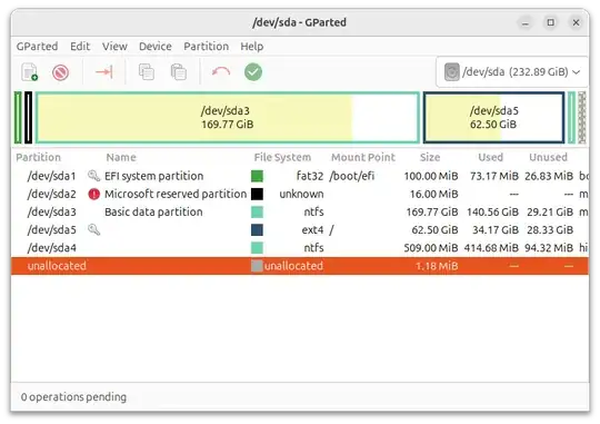

I am using Ubuntu 22.04 with two hard drives as follows:
  1. /dev/sda :
  2. /dev/sdb :
How can I use the free space on the second drive, /dev/sdb, for Ubuntu?
