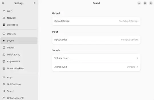

I currently have a dell xps 14 that I put ubuntu 24 on. I have tried mainline to try different version of the kernel to no avail
But the issue is when I am logged in my nav bar looks like so enter image description here and my settings show no audio devices enter image description here But when I boot the laptop before I log in, I see the speaker and can adjust the volume and it makes noises.

First I had to open and edit /etc/modprobe.d/alsa-base.conf and add
options snd-hda-intel model=auto
blacklist snd_soc_avs
to the bottom of the file and reboot. Then
Run commands as your normal user (no sudo) Make sure you’re not using sudo:
systemctl --user status pipewire.service
You’ll see that it's masked.
Unmask the Service Try unmasking the pipewire.service unit:
systemctl --user unmask pipewire.service
If this doesn’t give an error, follow it with:
systemctl --user daemon-reload
Remove Any Local Masking Symlinks If systemctl --user unmask pipewire.service reports that the unit doesn’t exist or doesn’t remove the mask, there could be a local symlink masking it in your user’s systemd config directory. Check for a symlink to /dev/null:
ls -l ~/.config/systemd/user/pipewire.service
If you see a symlink pointing to /dev/null, remove it:
rm ~/.config/systemd/user/pipewire.service
Check if the PipeWire Unit Files Are Present Confirm that pipewire.service and related unit files exist in the system directories:
ls /usr/lib/systemd/user/pipewire.service
If the file doesn’t exist, reinstall PipeWire:
sudo apt update
sudo apt install --reinstall pipewire pipewire-pulse wireplumber
Enable and Start PipeWire and WirePlumber (Without sudo) Now enable and start the units:
systemctl --user enable pipewire.socket
systemctl --user enable wireplumber.service
systemctl --user start pipewire.socket systemctl --user start wireplumber.service
Check their statuses:
systemctl --user status pipewire.socket
systemctl --user status wireplumber.service
Log Out / Reboot If Needed If the service is still masked or not starting, log out and log back in, or reboot:
sudo reboot
After restarting, run:
