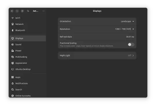

I have troulbe with my camera display (on Lenovo Ideapad elemental 14 intel i7 1255u), that I cannot joint vedio conference, the webcam isn't displaying.
I run a couple of test and compare with my system specification. My system specification (from the website of manufacturer) is:
               Display
1920x1080 FullHD 14" IPS Matte display
16:9 Aspect Ratio
I do not know what happens, but this seems to be changed, and I cant get it set back.

How do I reset the display to its original resolution 1920x1080`?

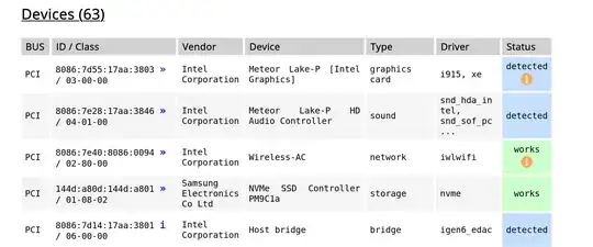

edit-5:
I generated a snapshot of my computer's hardware state, like so:
$ sudo -E hw-probe -all -upload
[sudo] password for xxxx:
Probe for hardware ... Ok
Reading logs ... Ok
Uploaded to DB, Thank you!
Probe uploaded here.
Looks like there's a problem with the graphic's card, screenshot below.
