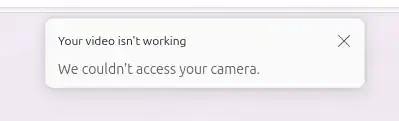

I am using Microsoft Teams PWA (Progressive Web Apps) for work. Recently I found that the screen sharing becomes abnormal.
There are 3 types of sharing options: (1)Microsoft Edge tabs; (2) Window; (3) Entire screen. All These 3 options worked well before.
About two weeks ago, suddenly I found that I can only share Microsoft Edge tabs. Sharing window or entire screen will show an error info "Your video isn't working. We couldn't access your camera."
I tried both Teams web page version and Teams PWA, the issue is the same. I also found that some people reported on github that unofficial Teams App is suffering from similar issue as well. (https://github.com/IsmaelMartinez/teams-for-linux/issues/1463)
I tried switching wayland to x11. The issue still exists.
I guess it's a bug about permissions or security or privacy settings. I'm not sure it's Microsoft Teams's issue or Microsoft Edge's issue or something wrong with OS.
Is there anything else I can try? Such as change some system or browser settings. And, could anyone help to send this issue to Microsoft?

error info
