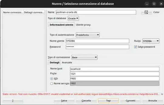

but when I connect to it I keep getting all sorts of errors see imageenter image description here.
So It is my understanding that now I should be able to connect to localhost:1521 as SYSDBA using FREE sid. Alas I keep getting the error ORA-01017. Does anyone knows how should I connect to it?

Connect to root database (FREE)
export TWO_TASK=localhost/FREE
sqlplus sys/Welcome_#1 as sysdba
SQL*Plus: Release 19.0.0.0.0 - Production on Tue Nov 26 15:33:38 2024 Version 19.8.0.0.0
Copyright (c) 1982, 2020, Oracle. All rights reserved.
Connected to: Oracle Database 23ai Free Release 23.0.0.0.0 - Develop, Learn, and Run for Free Version 23.5.0.24.07
sys@FREE> show pdbs
CON_ID CON_NAME                       OPEN MODE  RESTRICTED
     2 PDB$SEED                       READ ONLY  NO
     3 FREEPDB1                       READ WRITE NO
Connect to pluggable database FREEPDB1
export TWO_TASK=localhost/FREEPDB1
SQL*Plus: Release 19.0.0.0.0 - Production on Tue Nov 26 15:33:27 2024 Version 19.8.0.0.0
sys@FREEPDB1>
For multitenant architecture, you no longer use SID. You can, but don't go there. SERVICE_NAME is the way to connect using sqlplus, sqlcl or SQL Developer.
