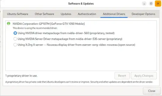

I don't know if it a coincidence or not, however after upgrading to 24.10 it started taking tooooo much time (almost two minutes with peak CPU usage) to display the Additional Drivers tab in Software & Updates:
