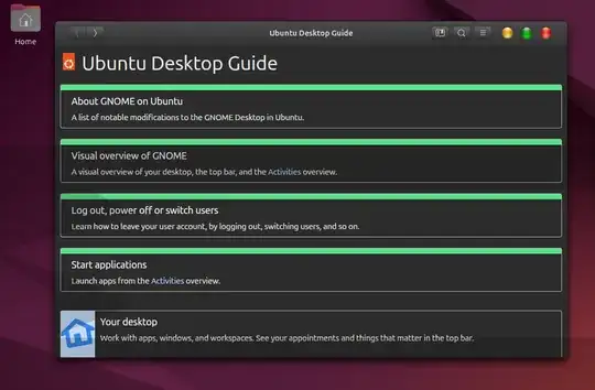

Using my theme the help page looks like this: 1
That might not be your favorite theme but it clearly shows that the provided themes have a flaw. You can install my "light theme" as well from here
