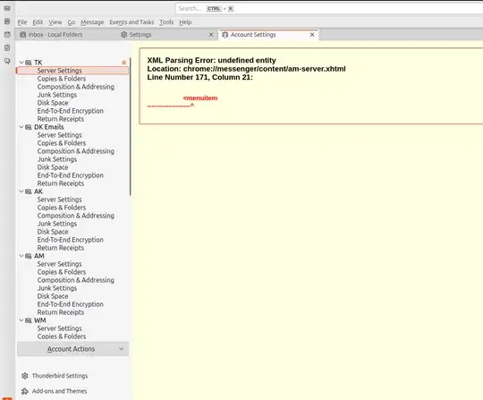

I note that if I try to view my Settings > Server Settings I see this instead:
XML Parsing Error: undefined entity Location: chrome://messenger/content/am-server.xhtml Line Number 171, Column 21: <menuitem --------------------^

I have the same error on the server settings for all my email addresses. Nonetheless my emails are working fine, in and out.
So I think this is a TB-wide error rather than something wrong with your own setup. Refer to TB forum reports on this. There is a proposed fix here and it is to be consolidated into the 128.3.2 version.
TB Server Settings Error
