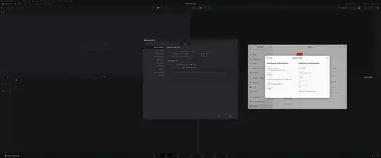

DaVinci Resolve running on Ubuntu 24.04 on Intel hardware: enter image description here

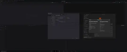

DaVinci Resolve running on Ubuntu 24.04 on AMD hardware: enter image description here
