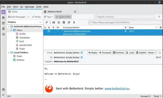

My Own Experience:
I have changed to Betterbird - a Flatpak fork of TB and it really is just better.
Betterbird is a fine-tuned version of Mozilla Thunderbird, Thunderbird on steroids, if you will. Betterbird is better than Thunderbird in three ways: It contains new features exclusive to Betterbird, it contains bug fixes exclusive to Betterbird and it contains fixes that Thunderbird may ship at a later stage.
You'll first need to install Flatpak Ubuntu Handbook then go to Flathub and search for Betterbird

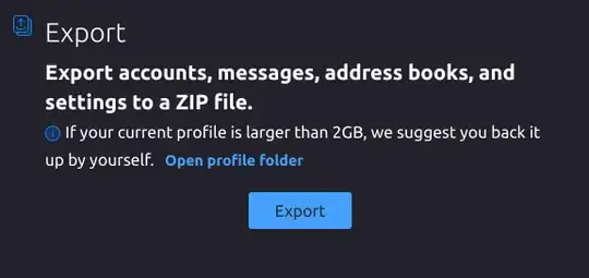

Before departing Thunderbird, go to the hamburger menu ☰ -> Tools -> Export and export your accounts, messages, address books and settings to a zip file and then do the reverse in Betterbird and import them back. This will save a ton of time and effort.
