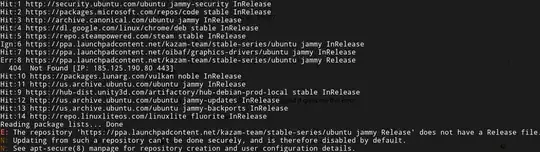

When I try to run the sudo apt update command it gives me this error:
Does someone how to solve this?
The kazam PPA is not available for your version of Ubuntu, hence this error.
Remove the ppa with
sudo add-apt-repositories --remove ppa:kazam-team/stable-series
You can install kazam from the official repositories instead.
sudo apt install kazam
